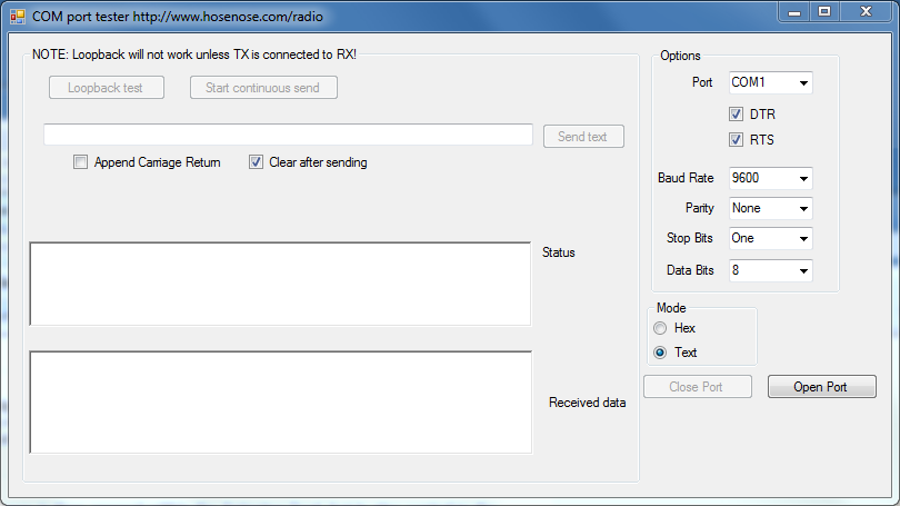

Rather than use Hyperterminal for your loopback test, we recommend using our free one-man serial port tester. The download link is at the bottom of this article. You may save it to your hard disk or run it directly from our server. See the link at the bottom of this article. No installation is required. It will run on any version of Microsoft Windows that has the .NET Framework 2.0 installed.
This utility is great for loopback testing because it has the ability to continuously send data out a serial port -- you do not have to type anything, leaving both hands free to connect the transmit and receive pins on the device being tested. It is also useful for determining which COM ports are installed on your computer, and monitoring data transmitted by other devices, testing baud rates, etc.
After you run the loopback tester, hold the mouse over the various controls to get help.
It is recommended that you first do a loopback test on a known good serial port. This will verify that you have everything set up correctly and are performing the test properly.
Testing the serial port
Select your com port in the port test utility, and click Open Port.
Click Start Continuous Send. This will cause the utility to continuously send the alphabet out your serial port. You SHOULD NOT see anything displayed in Received Data, since you have not yet connected the transmit and receive pins.

With the transmit and receive pins shorted together, you should see the alphabet appearing in the Received Data field. If this test fails, your port is bad, loopback connection is incorrect, or it is not the port number you think it is.
