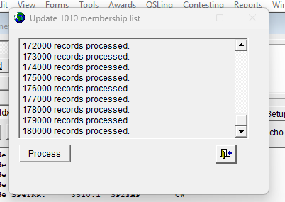

I tried to import the newest 10-10 list... I downloaded the zip file and unzipped it just fine. When I clicked on Process and pointed to the file, it started processing, but never got past 5000... it just seemed to be in a loop and did not finish. Then I could not stop and exit the processing without terminating LOGic.

OK, this time I restarted my computer and redownloaded 10-10.zip. After unzipping it, I tried 3 times. The 3rd time it took, but it never stopped. I finally had to use the task manager to end it after it got to 180,000 records, which I know is not possible, there aren't that many 10-10 members.
We'll just have to get together next week.
