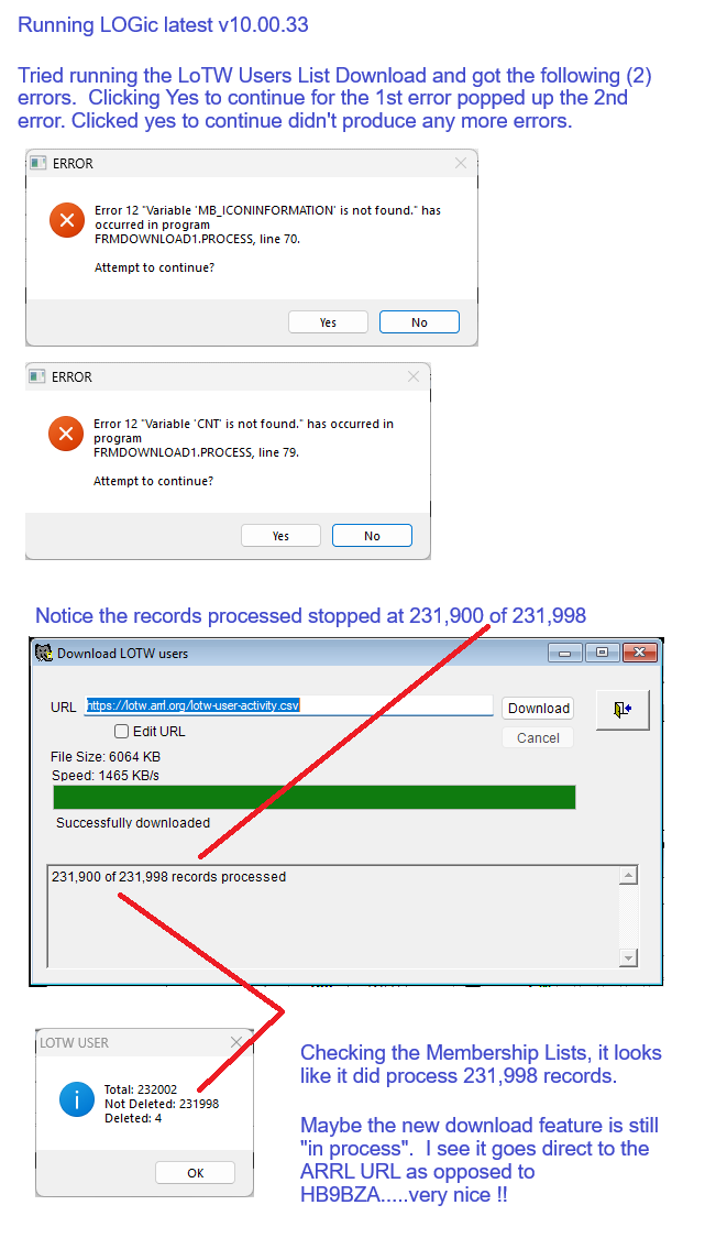

Tried the LoTW Users List download and got 2 errors. After clicking yes to continue it finished but reported fewer Users processed than downloaded. It was nice to see it goes to the ARRL URL for the csv list !! I seem to recall this may not be ready for primetime yet but just reporting the issue. See attached.

Right--it is not working currently. The code is fixed here. Will release an update Wednesday.

The update has been posted.

Works like a champ !!
Thanks Dennis !!
PS: Very nice to see the users last upload date in the Comment field !!!
