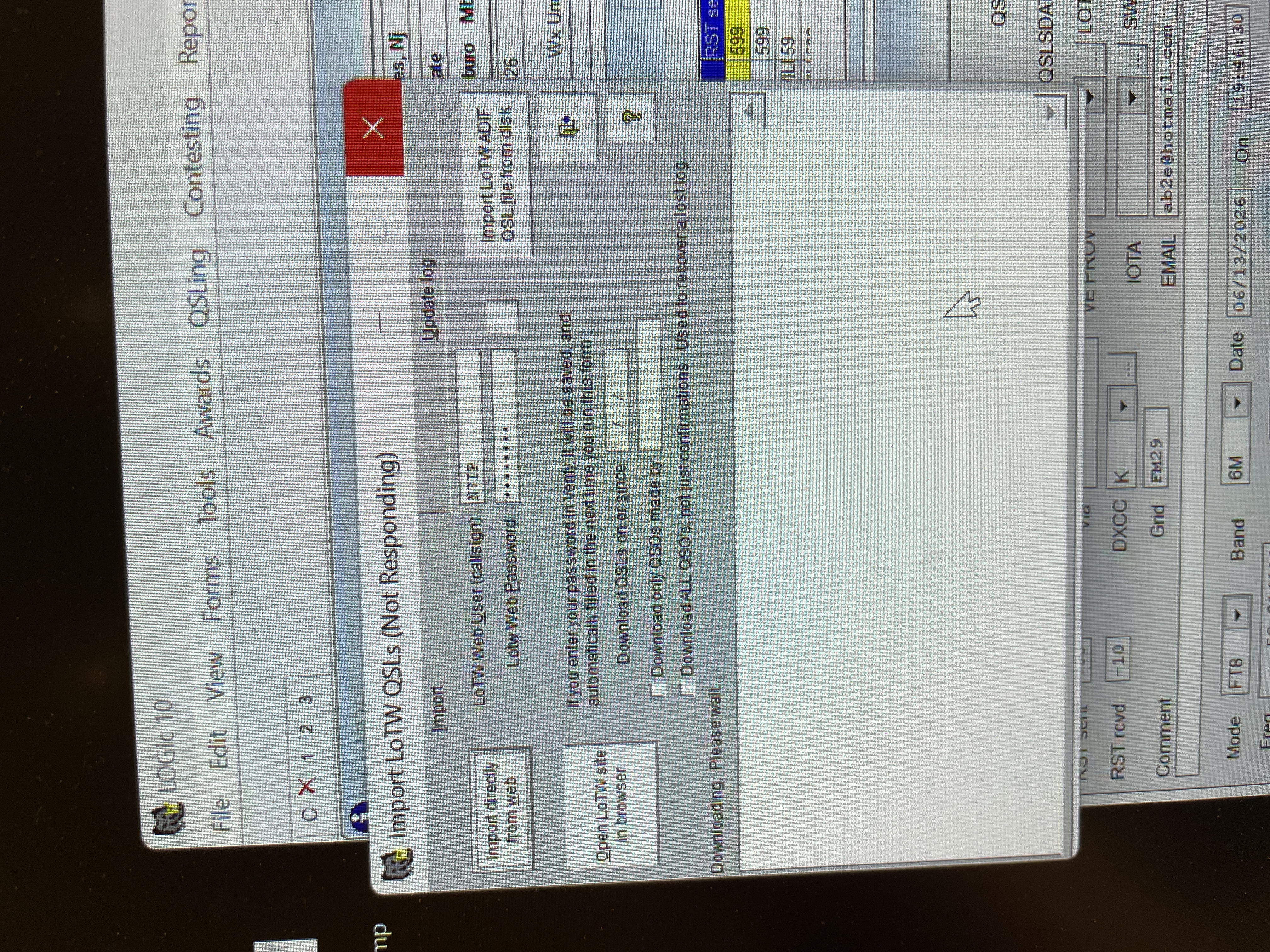

#10 Posted : Monday, June 15, 2026 11:50:16 AM(UTC)
Posts: 213
Dennis, update 33 did not solve this problem. See the screen shot attached.
Bob
1 user thanked N7IP for this useful post.
WN4AZY on 6/16/2026(UTC)
#11 Posted : Monday, June 15, 2026 9:30:02 PM(UTC)
Posts: 464
Thanks: 41 times
Was thanked: 78 time(s) in 73 post(s)
Bob
Bob, you're gonna have to enter in a date for "Download QSLs on or since". That's what mine kept losing, too. You'll have to go back to see the last download from LoTW and enter that date. PITA
