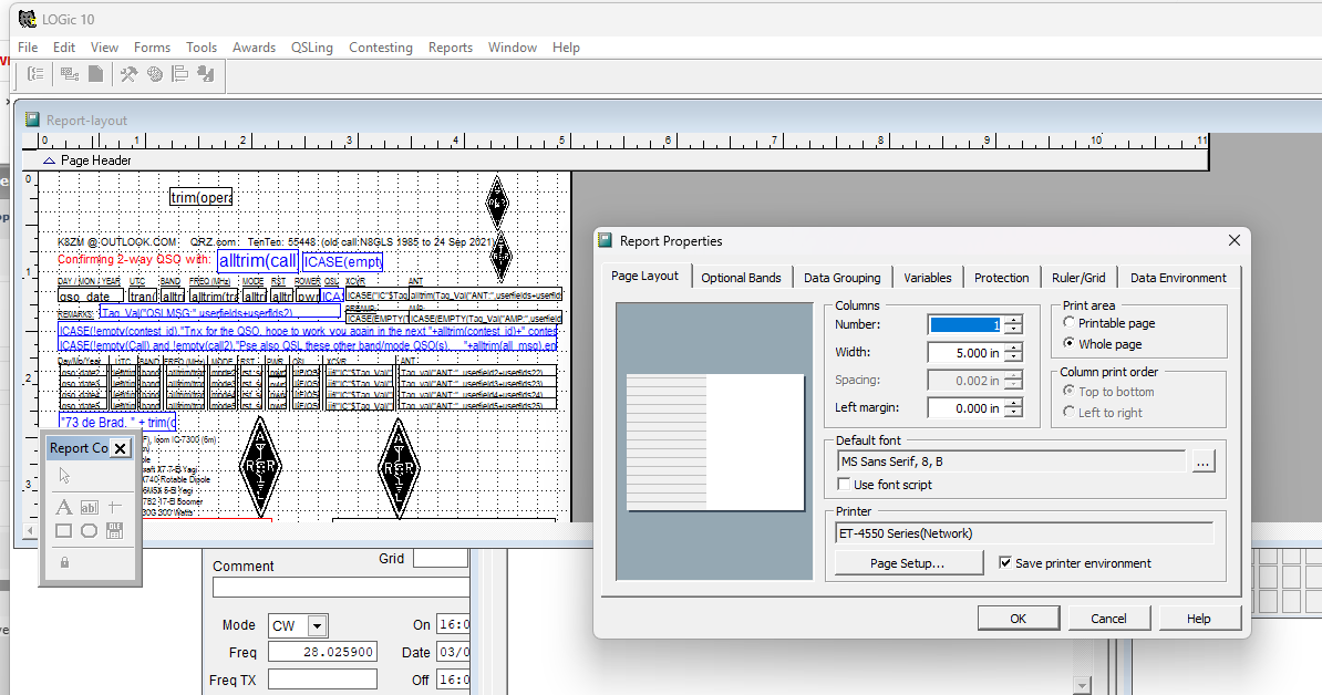

Tried running a couple QSL card reports to modify and am getting a Report Builder Error for margin box whenever I click on the Page Setup icon. See attached. Never had these issues before.
Running latest LOGic v10.032.
Thanks for any help.
Issue-20260324-Report Builder Error.png (11kb) downloaded 27 time(s).
Issue-20260324-Report Builder Error1.png (73kb) downloaded 24 time(s).

Here is one of them (note that the report title says 3.5 x 5.5 but its actually 3.5 x 5). This used to work a couple months ago but it seems I have 3 of these now that do the same thing when you click on Page Set Up. Its also weird that the header and footer bands are 11" or so wide when the card is only 5" wide.

When I went to open the report to modify it, it prompted for several image files. I just selected the ARRL Logo.
The report opened, and no error getting to the Page Setup.
Are you getting the error with every report?
k8zm Screenshot 2026-04-12 215736.png (102kb) downloaded 13 time(s).

Just curious but why is the Page Header and Page Footer band 11" wide ? The card is only 5. I just finished re-creating this one and both those bands are the same width as the card.
