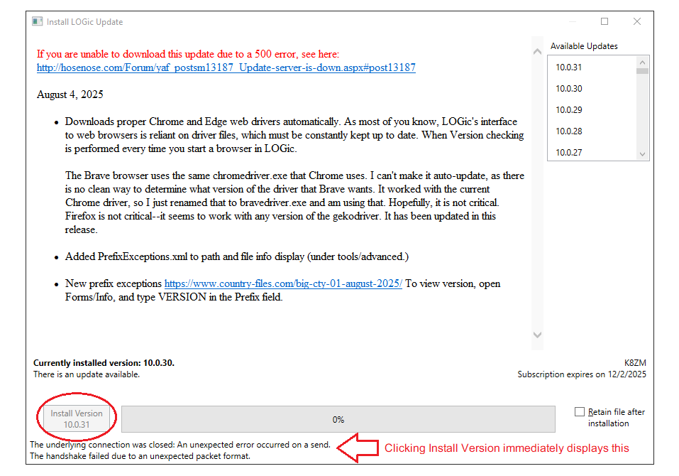

Tried to install v10.00.31 and got error "The underlying connection was closed: An unexpected error occurred on a send. The handshake failed due to an unexpected packet format". Snippet attached of the "Install LOGic Update" window.
Thought these types of errors only occurred on Mondays (hihi) !!
v10.00.31 Unexpected Error on Send.png (63kb) downloaded 132 time(s).

In the Updater, what exactly is happening when you click the "Install Version 10.0.31" button ?? Can you give me a list of what occurs first, second, etc ??
The instant I click on the "Install Version" button it immediately displays "The underlying connection was closed: An unexpected error occurred on a send. The handshake failed due to an unexpected packet format." This message comes up so fast I can't believe it. Once it shows it, it adds to the desktop the LogicUpdate_10.0.31.exe file even though I didnt check the "Retain the file after installation". Also if I try to close the Updater, it pops up a window saying a file download is in progress even though its not. I'm just trying to dive deeper into whats going on. Thanks for any help !!
v10.00.31 Unexpected Error on Send.png (67kb) downloaded 131 time(s).

The first thing that happens is that it downloads the update using HTTP pretty much like your browser. After the download completes, it runs the update. Then finally, after the installer exits, if RETAIN is not checkmarked, it deletes the download.
So it starts the download. It gets to the point of creating the empty file. The unhandled exception occurs and the program terminates before it can delete the file.
Check this out:
https://community.fabric...ected-error/td-p/3032659
