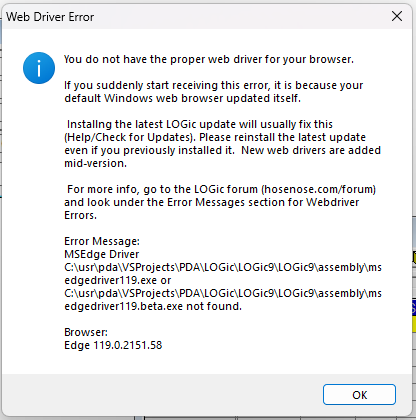

The next release of LOGic, which will be version 10.0.24, features better error reporting when a web driver error occurs. The user will be advised on how to remedy the situation.
New webdriver error message
Webdriver error.png (26kb) downloaded 310 time(s).
KD0PO
