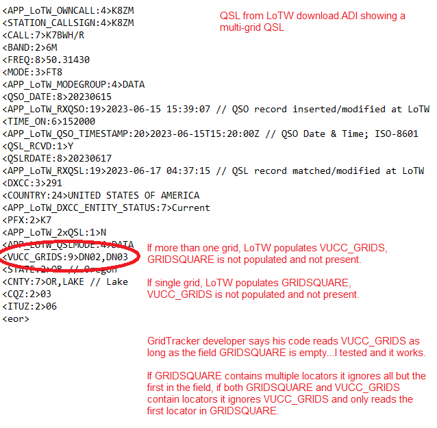

Also, when importing QSLs from LoTW, multi-grids/Qso are not importing. Attached is what I got today.
73 Brad, K8ZM
PS: I use GridTracker and am having a similar conversation with their developer. He goes by the ADIF standard which apparently says when there is a requirement to store two or four adjacent locators they must be in the field VUCC_GRIDS or MY_VUCC_GRIDS, also ONLY 4-character locators are allowed, i.e., EN90,EN91,EN92,EN93.
https://www.adif.org/314....htm#Maidenhead_Locator
My last LoTW QSL download in fact has the VUCC_GRIDS field populated if 2 or more locators, otherwise all single grid locators are in the field GRIDSQUARE.

Added this snippet showing a single multi-grid QSO I downloaded from LoTW (LOTW_Download_ADI) as it shows LoTW only populating VUCC_GRIDS when there is more than one locator and ignores GRIDSQUARE altogether.
The developer of GridTracker advised GridTracker reads VUCC_GRIDS when GRIDSQUARE is empty, I tested this and it works. If GRIDSQUARE contains multiple locators it ignores all but the first one, if both GRIDSQUARE and VUCC_GRIDS contain locators (which should never happen) it ignores VUCC_GRIDS and only reads the first locator in GRIDSQUARE. For me to use GT I export my LOGic log in ADIF format, then change GRIDSQUARE to VUCC_GRIDS for QSO's with multiple locators, then import into GridTracker. It works albiet a PITA.
