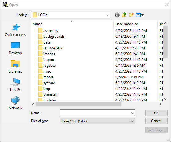

Just finished the ARRL June VHF Contest and had the following issues;
1) The cabrillo translation from within LOGic exports DA for the digital modes, it should be DG.
2) When running the Contest Summary with Multiplier report I get a window pop-up that is looking for some database file, pic attached. It takes hitting the ESC key on the keyboard about 15 times before it finally asks if you want to cancel the print job.
Thanks for any fix
***Just found that running any report pop's up that same window looking for some file to open.....ugh.
WN4AZY on 6/16/2023(UTC)
