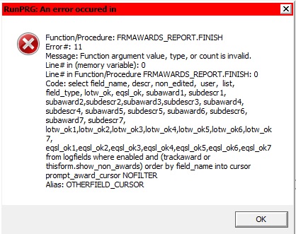

I get the attached error message when I try to show the report for -
Reports > Awards > AWARDS > DXCC and Main > 160M and CW > don't print unworked > DXCCSUB: for tag > blank for optional column
And at that point click on Finish.

Close Telnet or DX Summit or anything feeding spots to the spot log while running this report. A bug obviously. We are working to track it down.
