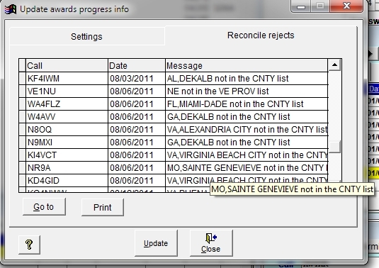

For a long time, when I do an AWARDS; UPDATE AWARDS PROGRESS INFO, I get a huge number of rejects, mostly counties (the Message reads for example "MO,ST. LOUIS not in the CNTY list". I suspect my countly list is corrupted possibly. What is the solution for this?

The problem is caused by callbook import of counties that do not match what is in LOGic exactly. GA,DE KALB and GA,DEKALB for example. Or ST. vs SAINT.
We are in the process of updating LOGIc's list to match the ARRL LoTW list. That should be as authorative a status as you can get. Then try to be a little more intelligent about using the post office data.
For now if you don't track counties, don't worry about it. If you do, it is a manual fix. Click the GO TO button then select the proper county on the log form. Hold the mouse over the CNTY field to see the invalid value in the database.
I think that LOGic no longer logs a USPS county that is not in the list.
