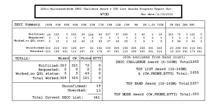

I have been fussing around with the DXCC summary report. I have written you before about it. In looking very closely I have identified the exact problem.
Please refer to the attached file.
In the upper right corner of the report you will see that Logic gives me credit for 321 confirmed on CW, 72 confirmed on DAT, and 122 confirmed on PHO. Those are all good numbers.
In the center left of the report the same information should appear but the report shows 321 Confirmed on CW, 72 on PHO, and none on RTTY.
The Data or RTTY totals are listed under the Phone column and the RTTY or Dat column has zeros in it. Other numbers in those columns are switched as well.
I hope this explanation is understandable. Could you confirm that you understand and let me know if there is anything I can do to correct the problem?

Ok, delete IMG from tools/setup/modes, do awards/update awards progress info, and I think it will be OK.
However, a separate report for Challenge is no longer needed. Just use any of the usual awards tracking methods and select CHALLENGE for the subaward.

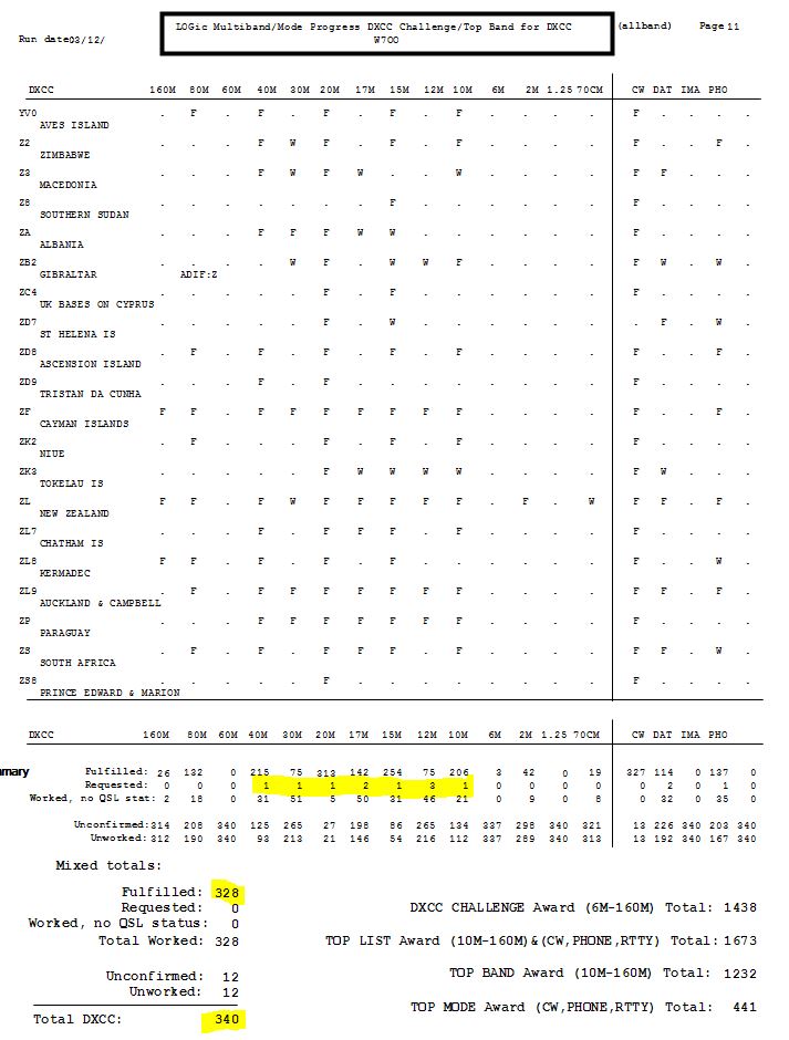

All band and mode awards progress -- DXCC Challenge
This report lists all of the countries and then summarizes the information at the end. Interestingly enough the country count is correct showing 340 countries. This report will meet my needs. The only problem with it is that it does not total requested QSLs as it should nor does it total Worked no QSL. I have highlighted the attached report.
This report includes deleted countries (I think). It also has the problem of not totaling requested QSL and it does not total No QSL Sent. The DXCC country count is 341.
I have attached a cards needed report as well. This is accurate in my case for active countries. All of the other reports should show a total mixed confirmed of 328.

Thanks Dennis, I really appreciate the help on this. As I am approaching the Honor Roll these reports are becoming very important to me. Logic does a much better job of organizing the data than I can do by hand considering I keep receiving new country confirmations on LoTW and therefore pulling the paper cards I need to apply would keep changing. I love the way LoTW keeps track of all of this automatically.
Progress DXCC Challenge 3-13-13.JPG (104kb) downloaded 65 time(s).
multiband awards 3-13-13.JPG (45kb) downloaded 62 time(s).
Progress DXCC 3-13-13.JPG (83kb) downloaded 62 time(s).
Cards needed 3-13-13.JPG (39kb) downloaded 62 time(s).

Ok, first off I see that you did not select CHALLENGE for the subaward when running these reports. You may have to scroll down to get to it.
If it is not there, go to tools/advanced/log fields. Locate DXCC. Enter a subaward
Description is CHALLENGE
For expressio copy and paste this (there should not be a line break after LISTS.DELETED -- you may have to paste it into notepad and fix it first)
QSO_DATE >{^1945-11-15} AND NOT LISTS.DELETED
AND INLIST(ALLTRIM(BAND), "160M","80M","40M","30M","20M","17M","15M","12M","10M","6M")
It should already be there though.
When you run a report and select the subaward, it should say CHALLENGE under the report title. I just tested it on the AWARDS report.
Do get the latest update. My All Band and Mode Summary shows a total for Requested. It is missing column header for CW on the summary page which I will fix, but looks good otherwise.
Deleted status is in tools/setup/lists of valid values. The prefix table has nothing to do with awards tracking.
