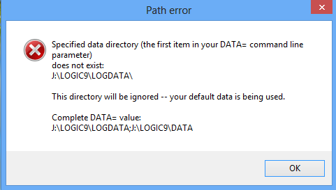

I recently re-installed LOGic 9 on my new Windows 8 machine. I keep my data files on a network drive and use the parameter "C:\Program Files (x86)\LOGic\LOGic.exe" DATA=J:\LOGic9\logdata;J:\LOGic9\data in the shortcut to load the correct files. This worked fine in previous versions of Windows, and still does on my other, Windows 7, machine. But on Windows 8 I get the error below. It's as if LOGic somehow can't see the network. I have the program set up to "Run as Administrator" Any ideas?
Gord
P.S. Running in Windows 7 compatibility mode generates the second error about FoxPro.

Ok, so don't run it in Win 7 compatibility mode then. I didn't run LOGic in win 7 compatibility mode, just the install program SETUP.EXE. Now I don't even have to do that.
As for the network....
LOGic is just doing a DIR command for j:\logic9\logdata
Here is a test you can do. Go to tools/advanced/database commands. Type
public array arr
? adir(arr, "J:\LOGIC9\LOGDATA", "D")
It should print 1, the number of items found. This command shows the actual results:
display memory like arr
It will show the name of the directory and the date and time, provided the adir command actually succeeded.
Anyway, what I would make sure that Windows Expolrer has full access to the directory. Copy a file there. Delete it. Create a file there, delete it.
You could do away with the drive mapping. Just use UNC \\machine\share.... I have no reason to believe it would make any difference -- just something to try.
Let me know!

No, I wasn't using it in Win 7 compatibility mode, only tried it to see if worked any better. Anyway, there apparently is some sort of issue with Windows 8 and network paths - it's an issue in other programs as well and gets some mention on the Windows Support site as well. Your suggestion of using the UNC method works fine.
Thanks!
