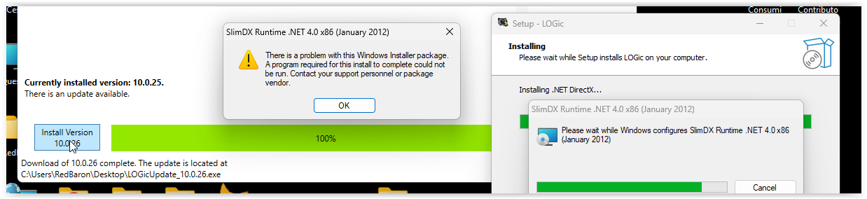

When updating to version 0.26 I got this error message.
However I managed to finish the installation ignoring the error.
I don't know which program is not executed but I think it is right that you are aware of this event.
Thank you.
Mauro IKØCHU

Hi Mauro:
Sorry for the problem.
I have seen this a few times before. Not sure what the problem is.
The error is with the SlimDX library which LOGic uses for the voice keyer and spot announcement. It is already installed on this machine, so you can safely ignore the error.
If you ever needed to install SlimDX, for a new installation on a new computer, and you still get that error, you can download it and install it manually.
https://distribution.hosenose.com/public/
Tnx for using LOGIc.
