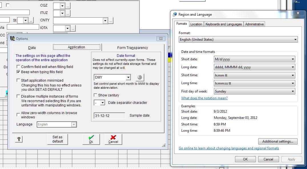

#5 Posted : Monday, September 3, 2012 8:02:19 PM(UTC)
Ok, I can reproduce it here, ONLY IF ENTERING ONE DATE for when using BETWEEN, and some other select such as Band as you say. I fixed that and it will be in the next update.
If you are getting errors and putting in both dates for BETWEEN, it is probably the date format you are using. Send me a screen shot of LOGic's TOOLS/OPTIONS date setting, and Windows control panel date settings. I have attached an example of what I want.
VE2XK
#6 Posted : Tuesday, September 4, 2012 6:01:44 PM(UTC)
Posts: 28
Problem not resolve with the following setting
Setting requested
Another fault
You can see yourself that just by gaving the date without to select between i got another fault again.
Similar that my example #2 above
I have this problem since i have Logic 9 under Windows 7 64X I never had this problem on Logic 8 by using XP.
Let me know what i can more try.
73's Michel VE2XK
#7 Posted : Wednesday, September 5, 2012 9:54:17 AM(UTC)
I tried setting mine up as yours and it still works.
And you aren't entering anything for STATE?
Please click the VIEW button and send me the results.
VE2XK

#9 Posted : Friday, September 7, 2012 4:04:23 PM(UTC)
Ok, I was able to get this error. Do a filter, enter a Band or anything, then move the mouse cursor over the STATE field on the log form.
I will fix it.
