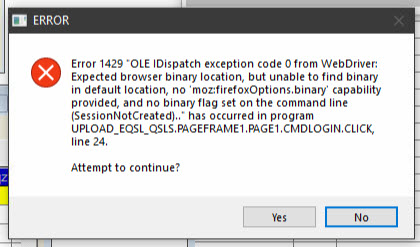

Just started getting this error when trying to upload eQSL. Am running Windows 10, LOGic 10.0.9, Firefox 106, gecko webdriver 0.32.0. Firefox is installed in the default location (C:\Program Files\Mozilla Firefox]. This error seems to indicate the binary is not in the expected location. See attached screencap of the message.
73s,
Don W2ZI

First of all, test on the CIA button of the Info form. That is a straightforward web lookup. It SHOULD give the same error, but just to make sure.
The CIA button is working fine with Firefox here.
#3 Posted : Monday, November 14, 2022 12:40:32 PM(UTC)
Dennis, the CIA button gives a similar error but in the show cia, line 17 module.
73s,
Don
