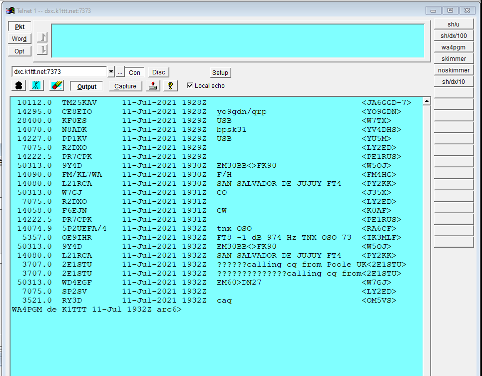

Screenshot 2021-07-11 144853.png (55kb) downloaded 74 time(s).

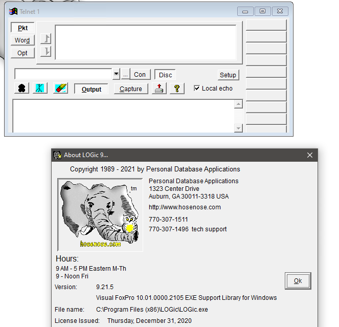

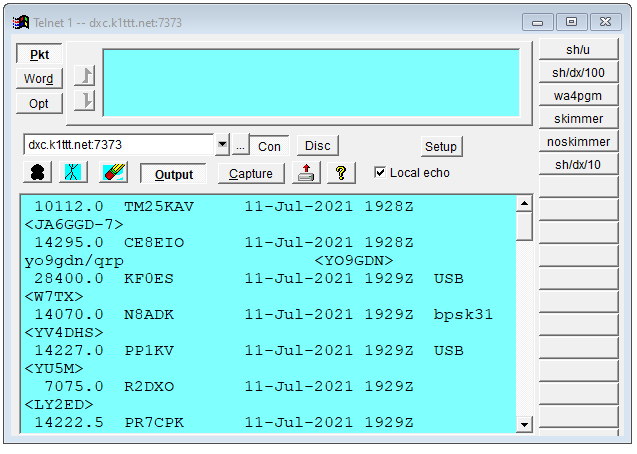

Working now, except in Import LoTW when clicking "Automatically Check in these QSLs I get OLE Dispatch exception code 0 ....
Telnet window does shrink but text become distorted. See attached photos.

There is nothing attached to your last post, and mine looks fine (I added some text to the buttons.)

Guess I forgot to add, lol
2021-07-11 15_33_29-LOGic 9.png (29kb) downloaded 74 time(s).
2021-07-11 15_32_59-LOGic 9.png (70kb) downloaded 63 time(s).

WA4PGM: I see what is happening. You are getting word wrap if the line is too long to fit in the window. Make the form wider, and/or right-click the received data area and select a smaller or different font. The default is fixed-pitch. Choose a variable-pitch font such as Arial and it will take up a lot less space, but columns of data will not align. 8 -point Courier is readable and doesn't take up a lot of space.

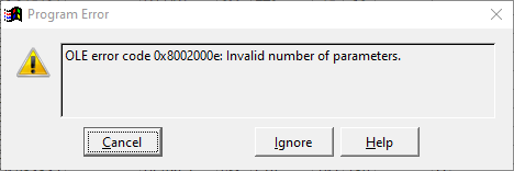

Uploaded FT8 QSO's to LoTW and got the attached OLE error screen, ignored twice and LOGic stopped complaining and seemed fine. Downloaded QSL's from LoTW and all was good except the LOTWRDATE field did not get populated. Its been running a couple hours but tomorrow will be running all day and I'll report more in-depth.
