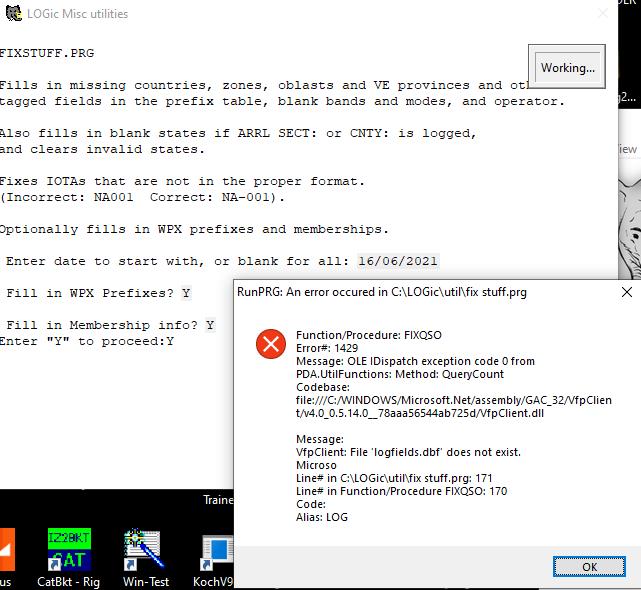

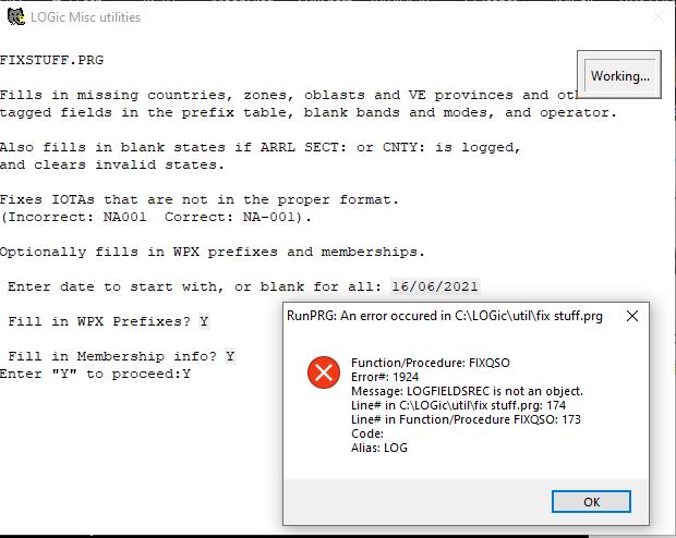

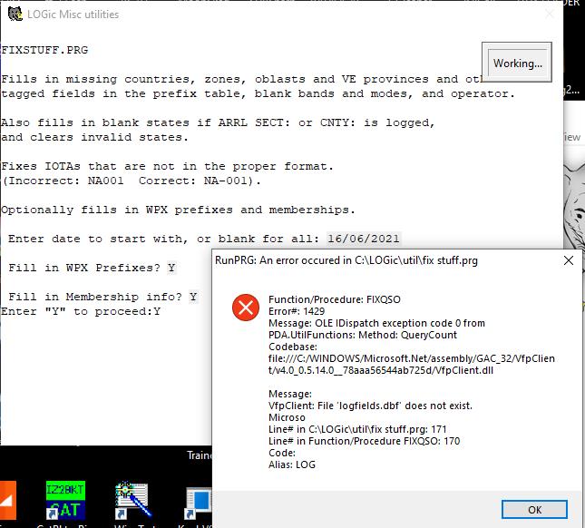

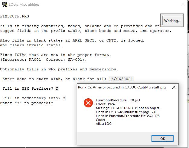

after the installation the system responded with error mode. In the past i made mods in modes list for some digital qsos but now, installing the version, that personal mods are discarded because missing the option to retain.
This night i transfered by adif mode 141 qso as usual and tried at first the option FIX STUFF and i received the warning attached. Pushing OK another warning appears. I have had to choose CTRL+ALT+DEL to exit.
I dont understand what is wrong here or missing.

Sorry. I think I found the problem. Please download and install .4 again.

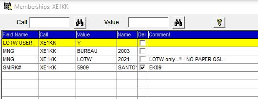

I tried the membership upgrade features.
These are my findings.
Thanks for testing it.
ADIF import phase:
In the input mask, if you enter the membership search activation flag, the same has no effect. That is, if you put on or leave it free, nothing changes. Imports as usual.
Fixed. Please download and install again.
FIXSTUFF:
It works perfectly. However, I have some suggestions if you think it might be useful. Some CALLS are present in many membership lists and I was thinking that the filling of the record of 255 characters could occur, frustrating subsequent implementations. So if possible in the FIXSTUFF phase you can decide which lists to import or maybe create a momentary personal table to identify which lists are most needed.
What I did was require that the ADIF IMPORT be turned on for membership lookup to work. I figure that if you don't want to import say QCWA#:, then you probably don't want it looked up either. So any memberships you want to look up, go to tools/setup/log fields, and make sure ADIF IMPORT is turned on.
The command to mass-change them all: Go to tools/setup/database commands:
USE LOGFIELDS
REPLACE IMPORT WITH .T. FOR MEMBERSHIP
BTW, next release I plan to double the 254-character limit.
