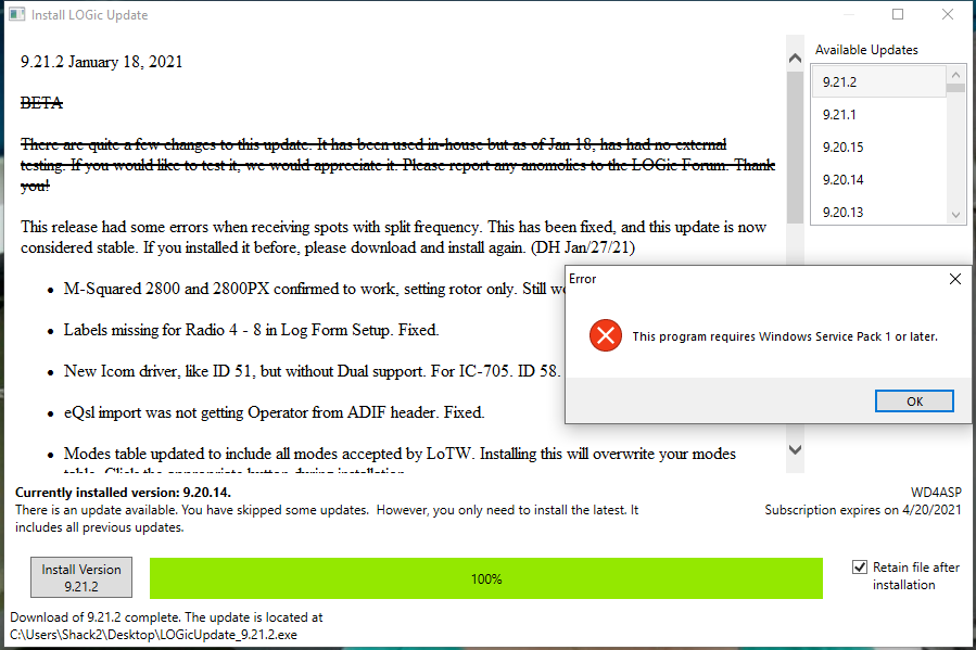

When I try to upgrade from 9.20.14 to 9.21.2 I get the following error:
"The program requires Windows Service Pack 1 or later."
This looks like a Windows 7 type error message but I am running Windows 10. Haven't had any problems previously doing the updates.

I am not sure what was causing the problem. One thing I was doing was not saving the installation file. It turned out saving or not saving it did not change the result.
I wanted to see if the problem was related to the 9.21.2 update only or would occur with a different update. I tried to install 9.20.15 without saving the installation file and that had the same problem. So then I saved the 9.21.2 installation file and after the error occurred I clicked OK which exited the installation program. I then ran the saved 9.21.2 installation file directly and that allowed the update to install.

Yeah, it wouldn't. The updater downloads the update program and attempts to run it. If RETAIN is not checked, it will delete it after install is complete or you cancel out of the update program.
For some reason, yours is not able to run the update program after it downloads it. And in this case, I don't know if it would delete it if RETAIN is not checked or not. So you did the right thing. Click RETAIN. Wait for the error. Then let Windows run it by double-clicking it.
