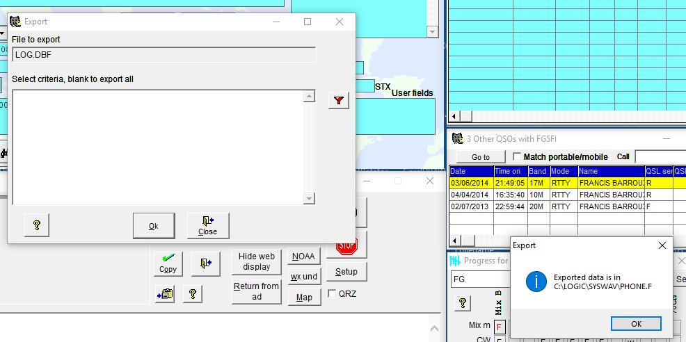

Whats happens?
#1 Posted : Wednesday, February 7, 2018 7:08:14 AM(UTC)
before update new versions, normally i make the export of entire log and copy the folder.
This morning to update to .030 version in the export log i got a message never received.
Whats means??
73's de IKØCHU
#2 Posted : Wednesday, February 7, 2018 1:39:02 PM(UTC)
It looks like you did an export and saved your data on top of the F sound file that says the letter F in a female voice. Also, is LOGic installed in C:\LOGic? Not saying that's what you did, but that's what it looks like hihi. Also, is LOGic installed in C:\LOGic? Let me know.
Dennis WN4AZ
#3 Posted : Wednesday, February 7, 2018 6:01:57 PM(UTC)
the mwssage has appeared but the export adi file was been written into the right folder located in disk D: and check it is OK.
The program is always in C:\Logic and the file phone.f is intact and no modified.
I try to export again with both versions .29 and .030 and all work fine. Hi but I did not do anything.
(I have female announcement in the spotlog so ... is it possible during the export the announcement was been activated by cluster?? Because is the first time that occurs this message)
Logging SY5CHP the Logic says SV but really is Dodecaneso SV5. I solved modifying the prefix table adding SY5 value into SV5 DXCC.
Also add a flag in Master DXCC because blank but i forgot to flag the user-supplied entry. So with the update .030 all came back and SY5 call report again Greece.
Is it right to add SY5 into SV5 and add also the maste for DXCC flag??? I would like to know if my idea is wrong or right.
Thanks and 73's
WN4AZY on 2/9/2018(UTC)
#4 Posted : Friday, February 9, 2018 9:24:03 AM(UTC)
Yes, you are correct. According to the Feb 5 '18 issue of BIG CTY, SV5 is a valid and unique prefix for Dodecanese. I will add it to my master.
