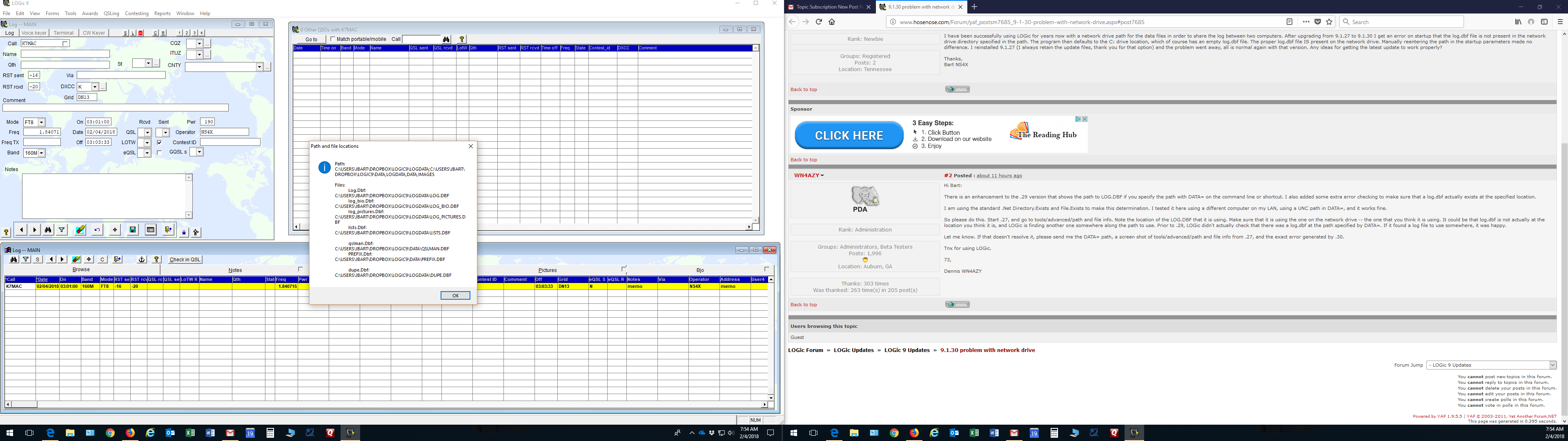

Thank you for such a quick response. Here is the path specified by DATA= that works in 9.1.27: "C:\Program Files (x86)\LOGic\LOGic.exe" data='C:\Users\jbart\Dropbox\LOGic9\logdata;C:\Users\jbart\Dropbox\LOGic9\data'
I will attempt to attach a screen shot of tools/advanced/path and file info from .27. It matches the expected path. As I mentioned in the original post, I use this network drive option to share the log file among multiple computers - two desktops and a laptop. This is something that I use frequently, so I would notice if the logs did not match.
I will need to reinstall 9.1.30 to reproduce the exact error message, so I will follow up with that.
Bart
Screenshot 2018-02-04 07.54.22.png (335kb) downloaded 144 time(s).

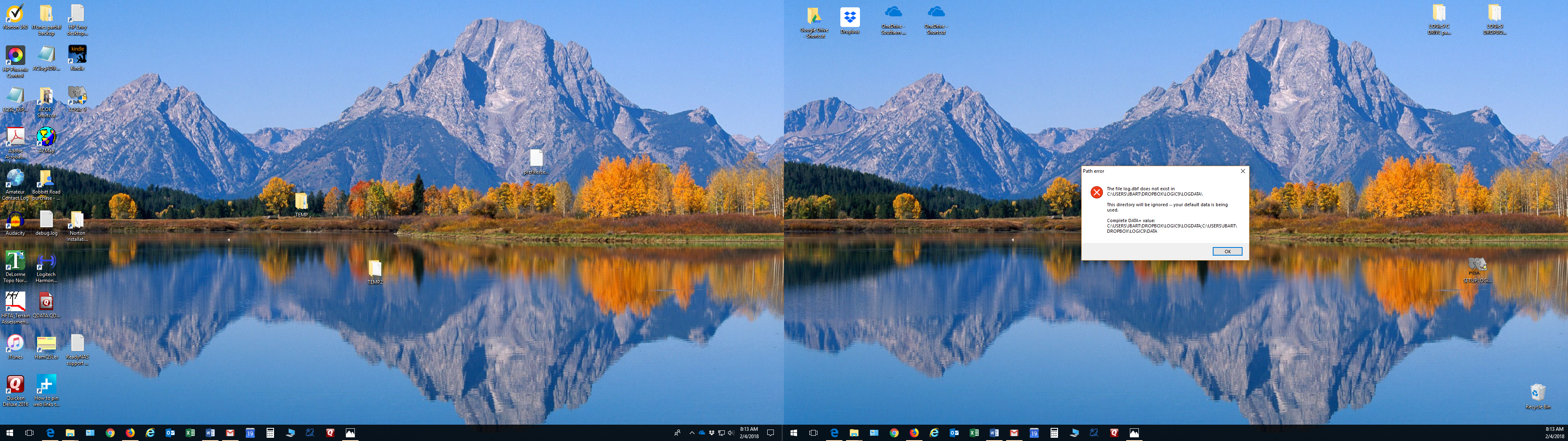

I am attaching a screenshot of the exact error generated by 9.1.30.
Bart
Screenshot 2018-02-04 08.13.11.png (3,277kb) downloaded 124 time(s).
