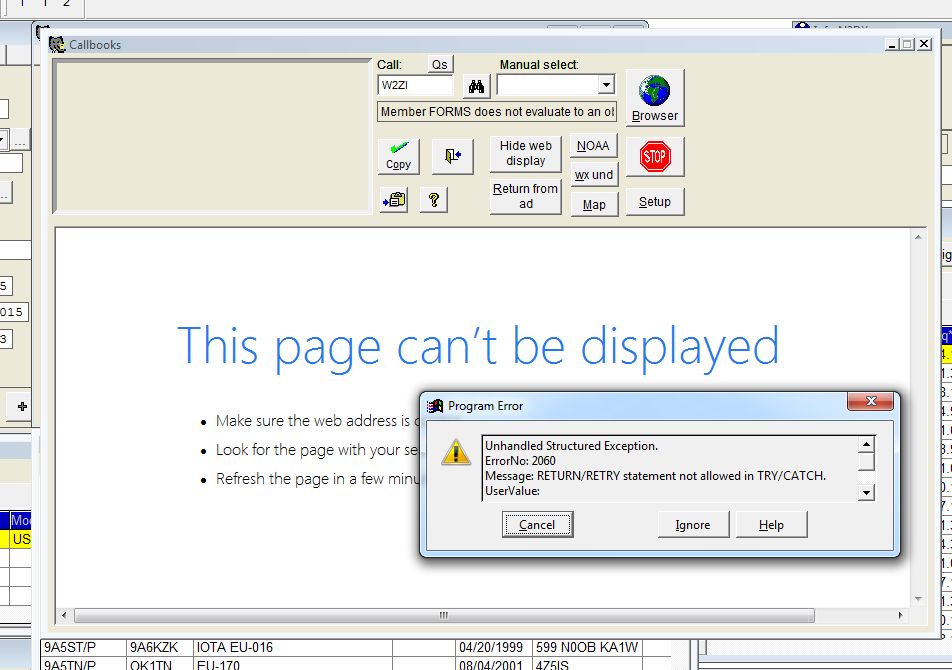

Hi. Running LOGic on 9.0.72 on a Windows 7 x32 box. When I lookup a call in the Callbooks form
with QRZ, it shows in the box (top left corner) as it should. If I choose FCC in the manual
drop down, it throws error 2060 Unhandled Structured Exception. see screenshot
73s, Don
callbook error.jpg (85kb) downloaded 75 time(s).

Sorry for the problem, & tnx for the screen shot. Big help!
I cannot reproduce the problem here, but looking at the code, I can tell that the HTML page is not what is expected. Make sure that you can browse to
http://wireless2.fcc.gov...earch/searchLicense.jsp
in your browser, and look up yourself.
There was an error in the error handling code which I fixed. However, the error you are seeing is a result of something else as described above.
I like UALR a lot better than FCC anyway. They update it nightly, so the amount of potentially newer data on the FCC site is trivial.
