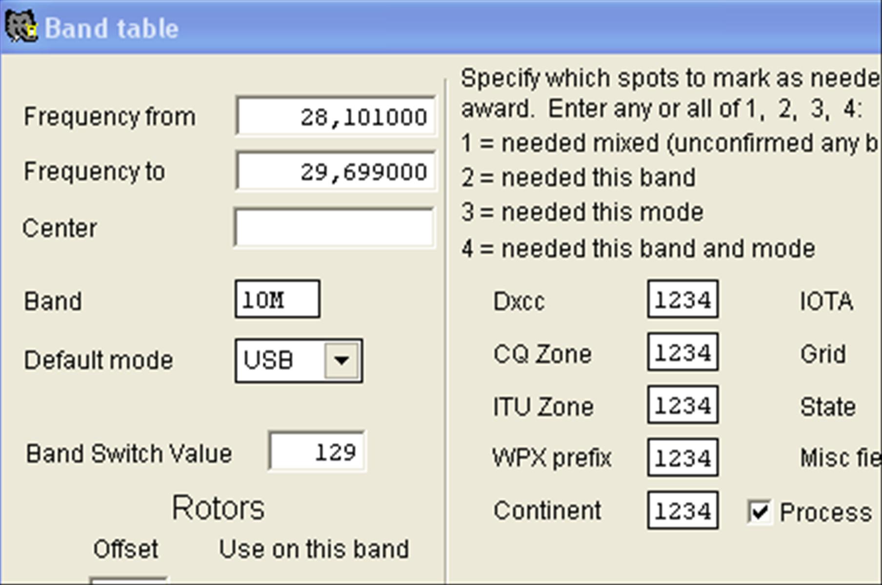

Hi,
someone tell me why, in the SPOT LOG, the value of DXCC I need is not shown in red color?
Point out that in the Table Band DXCC award is filled with 1234. (Screenshot)

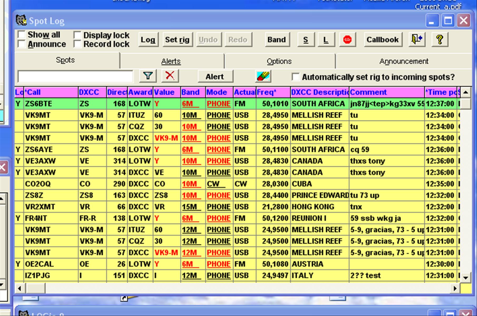

As you can see VU4 is black while the band and mode are red and underlined. (Screenshot)
73's de IK0CHU Mauro

Ok, you have never worked VU4? For DXCC, it means that you have VU4, but not on 10M (red) and not on phone (red), and not on 10M phone (underlined). From this I can conclude that you have VU4 on some other mode (CW), but not on 10M. Assuming everything is working OK.
What is the SPOT LEVEL set to? (options page)
Try Awards/Update awards progress info.

I solved my problem by adding the VALUE column, visible on the left side of the screen of the SPOT LOG. In fact, the value is displayed in red. (immage)
I thought, perhaps incorrectly, that it was right that even the columns of DXCC, and the Award should be red to identify the QSO to be carried out necessarily.
Thank you for your reply and I'm sorry I wasted your time unnecessarily. But wrong is learned hi
I attach the screenshot of the Spot Level setup, if I did something wrong let me know. (image)
I would like to offer You and if you think it is right to highlight in red DXCC and AWARD exclusively in the presence of a new one for each award chosen to display in the spot window. The news must immediately fill the eye to attract the necessary attention.

What is the 3rd column in your screen shot?
#5 Posted : Wednesday, April 2, 2014 10:43:19 AM(UTC)
Posts: 380
Thanks: 59 times
the 3th column is the beam direction (short path)to the displayed call.
How you can see in the screenshot303 i canghed the fields sequences as you recommended.
