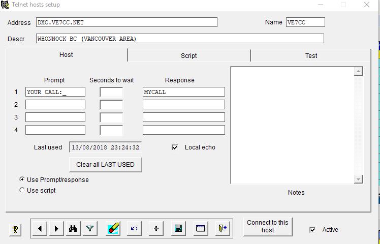

I use VE7CC for spots. Logic is still has trouble logging onto this site. See my setup attached. It times out 9 out of 10 times at startup. Then, when I disconnect and reconnect, it almost always logs on fine.

Changing to your setup still does not work. Here's the transcript and attached is the setup. If I disconnect and then reconnect, it works. That was also true when the first line of the setup was "call:"

LOGic> Waited for LOGIN: to be sent by host, but it was not.
LOGic> Check Setup.
n7ip telnet.pdf (439kb) downloaded 105 time(s).

this is my setup and i have no problem. (Screenshot)
My Telnet response …:

login: IK0CHUIK0CHU

N7IP: The cluster isn't sending the login: prompt, at least not within the default 10 seconds that it waits. No problem here tho over approximately 20 tests.
You can enter more time in setup.
IK0CHU: Turn off LOCAL ECHO. That will prevent it from doubling any info entered by you or auto login.
