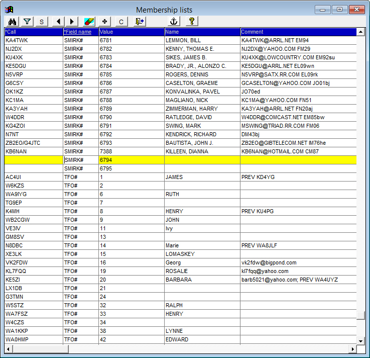

What happens is the records get imported but without the call sign. The FIELDNAME field is populated and the VALUE field is populated, but not the CALL field.

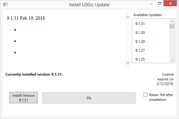

I did start LOGIC, go to check for updates, then I downloaded and installed 9.1.31. I then reran
the import procedcure but I got the same results as the first time that were shown in the video.
See the attached screens. You'll see the following:
1 - check for update screen after I updated,
2 - the ABOUT screen after updating.
3 - the import preview screen during the import of the two records
4 - the membership list screen after the import was complete. this screen shows the SMIRK#
added but no call signs for those two records.
