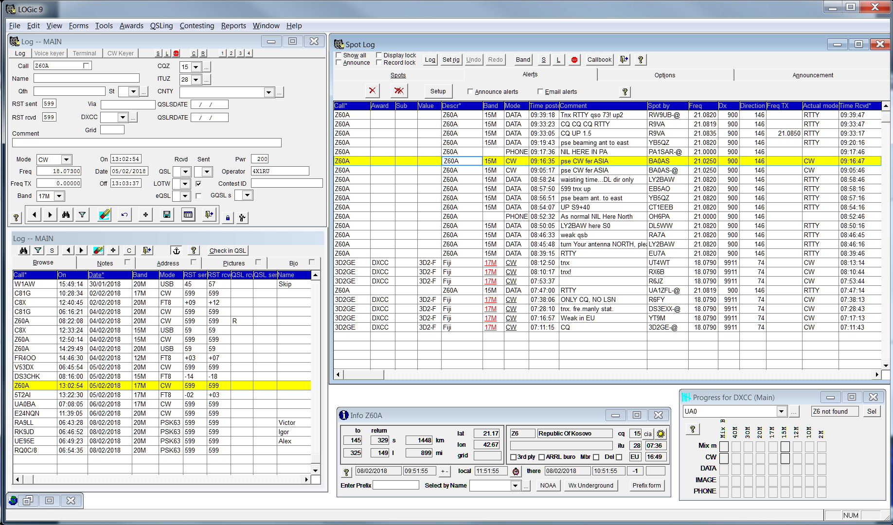

Z6 does appear in the Prefix List and the DX Calculator but LAT/LO seems to be reversed.
Z6 still appears as Servia in the Spot File.
The Main Log does not know what to do with Z6, leaves a blank.
Anyone else with this problem?

#5 Posted : Thursday, February 8, 2018 4:58:15 AM(UTC)
Posts: 28
Location: Israel
Thanks: 3 times
Was thanked: 5 time(s) in 5 post(s)
Shalom Dennis,
I've attached a screen snapshot of the Z6 problem. This might be helpful sorting this out.
73, Jim

#6 Posted : Friday, February 9, 2018 4:20:30 AM(UTC)
Posts: 28
Location: Israel
Thanks: 3 times
Problem solved for me.
Z6 was missing in the file "LIST OF VALID VALUES". So I added it under DXCC and that solves my problem. I don't know if that's the proper fix but it solves my problem .... until the next update.
Jim
#7 Posted : Friday, February 9, 2018 9:29:23 AM(UTC)
Glad you got it. It should have just added ZS6 in LIST OF VALID VALUES when you installed the .30 update (provided you checkmarked INSTALL NEW LISTS AND USER-DEFINED FIELDS).
