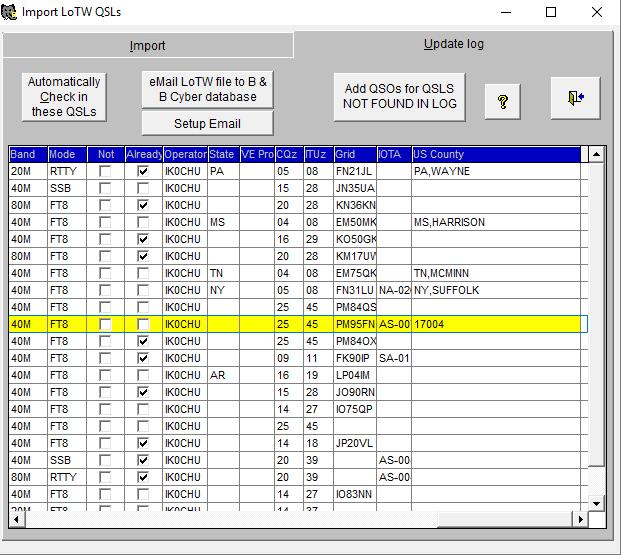

in my last importing file, this morning, I had an experience as follows:
The Logic version is .29.
Imported adi file with NA, SA, JA, UA stations for a total of 48 qso make this night. The import aws been right!
Updated all the qsos with Callbook batch updated
Updated the qsos with QSL.cc and LOTW.
Updated QSL_SENT and RIG fields with MASSE CHANGE in Advance Database Command.

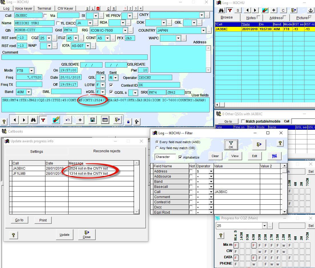

I ran fixstuff program to fill in the rest of fields and fix the wpx.

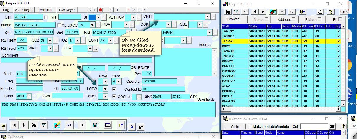

The CNTY field into USA qso was been empty.
Some JA qsos have had an update with CNTY value wich seems to be as JCC value.
The reason is fix stuff or LOTW wrong operation?
I sent You the adi file and an screenshot for information.
wsjtx_log2.zip (2kb) downloaded 115 time(s).

Ok, do you know what step that the CNTY got added? It isn't in the ADIF file you sent me. Can you send me the file that LoTW sent back to you? I suspect that they are using the CNTY field for Prefectures or Guns. I think LOGic's JCG field is Guns, and JCC is Prefectures.
Callbook import won't import anything that isn't on the CNTY list. I need to make LoTW do the same thing.

#7 Posted : Sunday, February 4, 2018 4:03:22 PM(UTC)
I think you need this informations to solve the problem.

#8 Posted : Sunday, February 4, 2018 6:20:38 PM(UTC)
The zip archive contains the folder i made with the data about lotw and eqsl.cc sent and received.
Now every time send and receive data i create a folder with the date to archive if need in the future. Can it be automatized during the operations?
Thanks and 73's
Hi Mauro--
I think all of the issues with LoTW have been fixed. The .30 update still displayed the JCC# in CNTY on the LOTW import screen as shown in your screenshot641. However, it was not actually imported into the log. Basically, a cosmetic error. I fixed that too, so if you download and install .30 again, it will not longer show up there.
