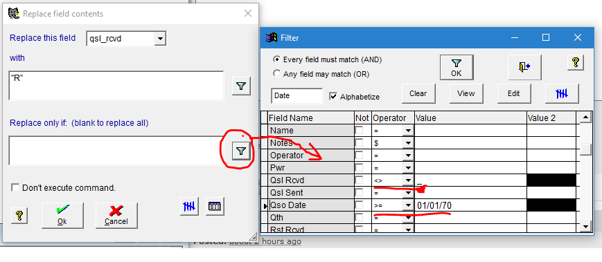

To put R in QSL_RCVD, just fill out the MASS CHANGE/REPLACE FIELD CONTENTS screen as per the attached screen shot.
This results in the following command:
replace qsl_rcvd with "R" for QSL_RCVD<>' ' AND QSO_DATE>={^1970-01-01}
Ok, this does only QSOs on or after Jan 1 '70. Don's example does only QSOs before Jan 1 '70. Not sure what you want, but you get the idea hihi.
#5 Posted : Monday, February 6, 2017 10:22:12 AM(UTC)
I'm assuming if there is already an "R", "F", "I" or "X" in the field, it will not change it to "R", right?
Or do I enter "R" in the second box where it says "Replace only if: (blank to replace all)"
Vin
#6 Posted : Monday, February 6, 2017 1:32:26 PM(UTC)
Posts: 3,259
Right. If there is anything in there other than a blank, ( <> " ") it will not change it.
If you want to do it the hard way, you could do this:
replace qsl_rcvd with "R" for QSL_RCVD<>"R" AND QSL_RCVD<>"F" AND QSL_RCVD<>"I" AND QSL_RCVD<>"X" AND QSO_DATE>={^1970-01-01}
You could do this if you want to make it even harder.
replace qsl_rcvd with "R" for QSL_RCVD<>"R" AND QSL_RCVD<>"F" AND QSL_RCVD<>"I" AND QSL_RCVD<>"X" AND QSL_RCVD<>"R" AND QSO_DATE>={^1970-01-01}
But it would just save a little disk activity because it won't rewrite an R where there is already one as the preceding example does.
#7 Posted : Monday, February 6, 2017 6:37:11 PM(UTC)
Worked great...thank you !!!!!
UPDATE: I spoke too soon. The mass change entered "R" for all QSO's, even if there was an "R", "F", "I" or "X" in the field prior to the mass change. Sad
Vin
