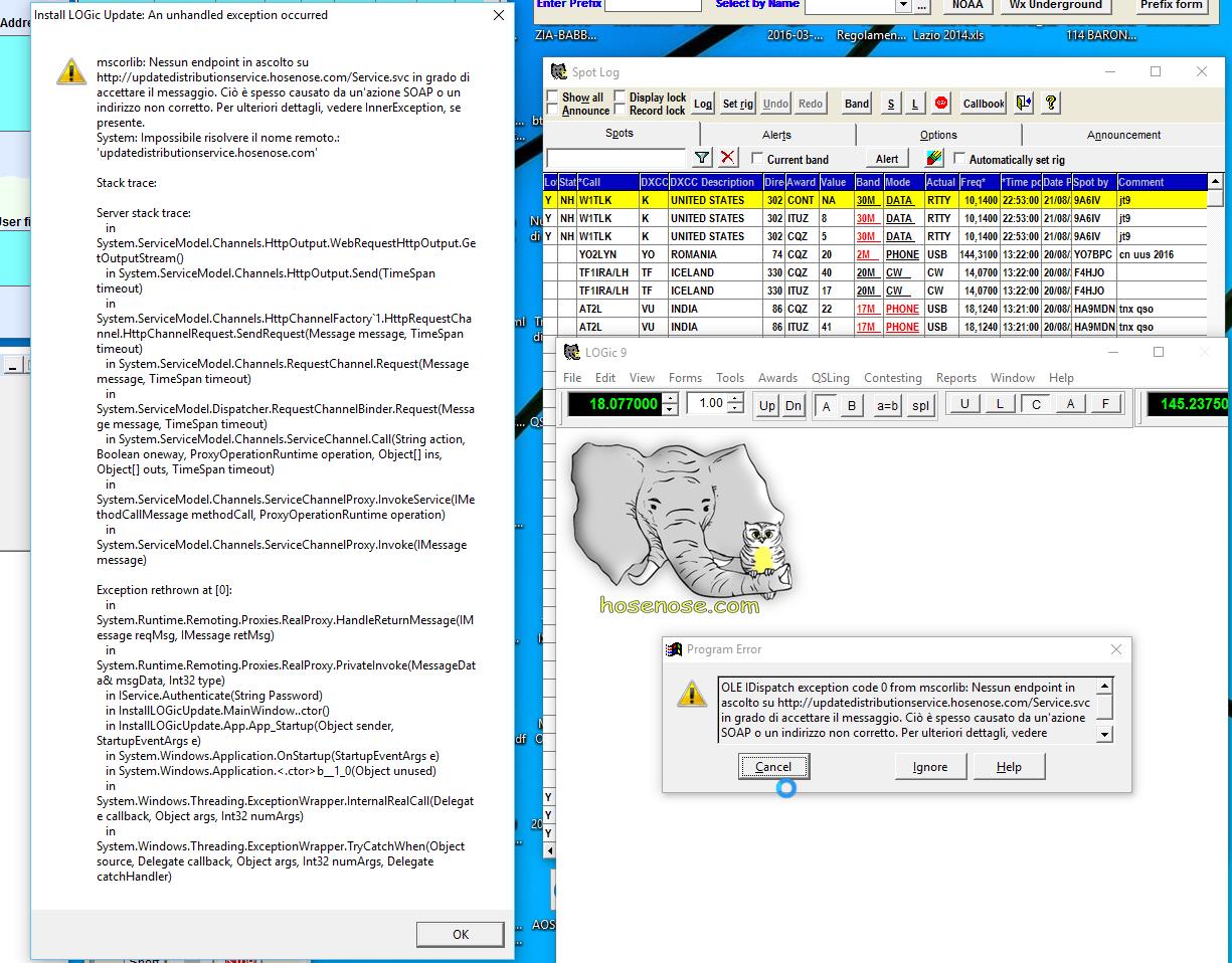

#6 Posted : Sunday, August 21, 2016 6:00:40 PM(UTC)
I tried to install 9.1.1 using the Help/Check for Updates in the Logic 9.0.1.
This is the error message received and the Logic restart. (Screenshot attached)
Thanks for help.
73's Mauro.
