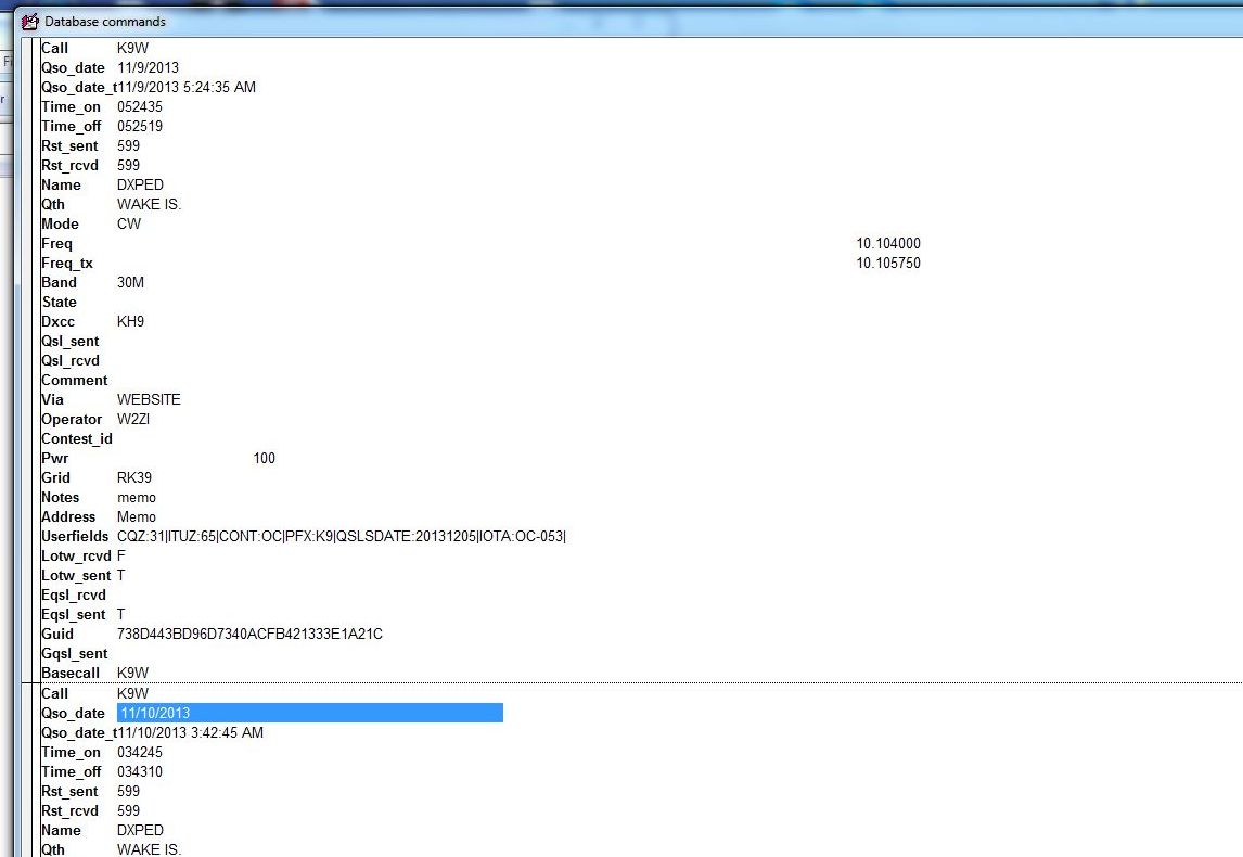

Got the ff error when I try to go to a particular call (K9W) in my my. Get the same error with the binoculars or just scrolling down the log and hit the call.
The error is:
OLE IDispatch exception code 0 from System.Core: Sequence contains more than one element..
I was able to go into Tools>Advanced>Database commands and see the records. They looked like any other record.
Thanks for the help.
Running Win7, 32bit, 2GB RAM, SSD drive (100GB free) LOGic 9.0.83
73s, Don
edit: attached PREFIX.DBF
k9w 1 crop.jpg (69kb) downloaded 63 time(s).
prefix.DBF (583kb) downloaded 64 time(s).

Thanks for sending the prefix table.
K9W_ has been entered in the prefix table twice. Delete the record with K9W_ by itself.
I am fixing the code so this won't be a problem in the future. Should have it up in a few hours.

#3 Posted : Tuesday, March 1, 2016 5:43:54 PM(UTC)
Thanks much. Removed user-supplied entry and that worked. Guess I had added the K9W entry
before you added it to the master entry. Since it does not delete my entries, I usually
take the prefix table when updating. Your new fix will be great as as I have several added
stations that you might (now) have in master records.
