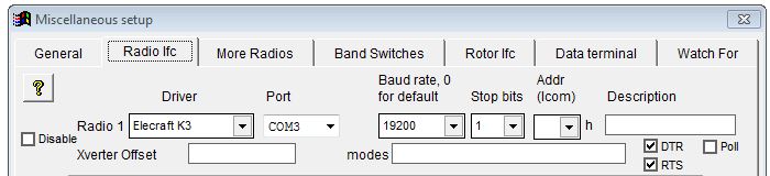

Where is this located? I see Polling interval in seconds(polled rigs only) is set to 2.0

Tools>Setup>Misc. ham setup>Radio ifc
See attached

I am not sure of the setting beforehand but I see that polling is NOT checked when switching back to the K3 driver. I never have to reset the connection nor see the frequency revert 00.0000 and stay that way.

Hmmm.... Another mystery. I have to set my POLLING to ON to keep the frequency in the rig control window from reverting to 00.0000, but it causes LOGic to crash more often when I do that.
