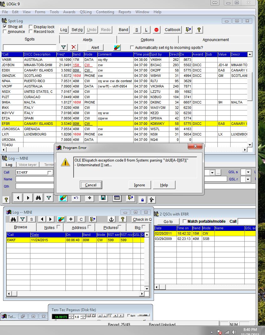

I have just moved my installation of LOGic 9 from an old computer to a brand new one. Both computers are Win7Pro 64. I used the original disk to start the new install, then upgraded from the web page and copied over just the file that has the log data.
I am getting constant errors like this one:
OLE IDispatch excpetion code 0 from System: parsing "\bUI(A-I][67][* - Unterminated [] set...
What do I have to do to fix this?
Ron

There is some problem with the prefix table. Try this:
Exit LOGic and delete the prefix table. It is named prefix.dbf and is located in the DATA folder inside the LOGic install folder. So in other words probably c:\program files (x86)\logic\data
Install the .79 update, and be sure to tell it to install the prefix update.
Let me know. The best way to reach me is to post here.

That seemed to do the trick! Thanks for your help.
Ron
