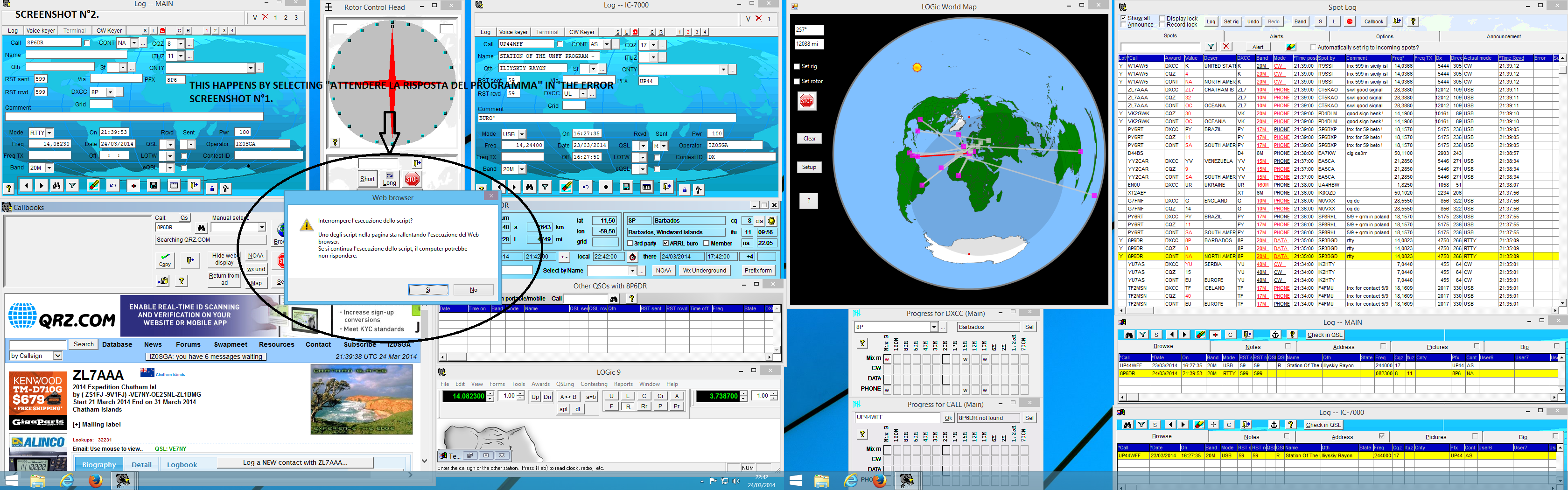

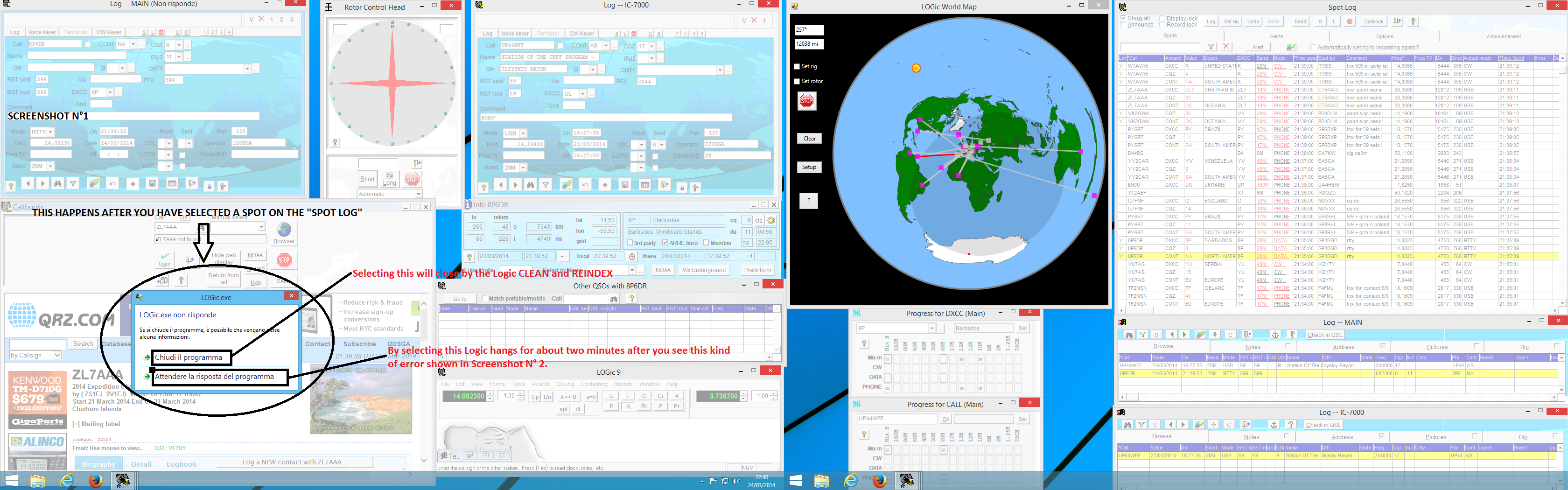

as you can see the frequencies of the devices are displayed properly, rotating the VFO of the radio.
By entering a name in the "LOG MAIN" and pressing TAB Logic works perfectly including all data including the frequency of the link when I made the connection.
I do not think it's a problem of USB_SERIAL Prolific I have never had a problem and Windows 8.1 during installation found automatically updated drivers without installing did in the manual. In addition, the USB_SERIAL Prolific work seamlessly with other software ham radio.Il problem occurs only when I use the "SPOT LOG" by clicking on a SPOT. SCREENSHOTS View to see the errors.Sad Sad Sad

Can you please translate the error message on the second screen shot for me? I see "script", it may be a problem with QRZ.COM. Try turning that off.
http://hosenose.com/Foru...up-Locks-up-Logic9.aspx

This is the translation of the error screenshot N°2.
Stop running the script?
One of the scripts on this page is slowing down the performance of the Web browser.
If you continue running the script, the computer may become unresponsive.
Thank you for your co-operation de 73's IZ0SGABigGrin BigGrin

Yeah, it's apparently QRZ.COM. See the link in my past post.
