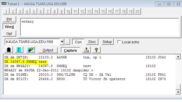

#4 Posted : Thursday, December 22, 2011 10:22:44 AM(UTC)
Posts: 3,256
Was thanked: 553 time(s) in 463 post(s)
Ok, actually,
DX/K7UA 14237.0 UA0IT COMMENT
or just
DX 14237.0 UA0IT COMMENT
is the proper format for sending a spot.
DX DE WN4AZY: 14067.8 DU2DX optional comment goes here
is the format that the cluster send spots to LOGic in.
I tried it on our local cluster and it works 100%. In the attached photo what LOGic sent is hilighted. The response is below -- a valid spot.
Try not filling out the SPOT BY field. The cluster may not support it. This is normally left blank anyway. See the touch help for this field.
If that doesn't work, tell me what cluster you are using so I can try it here.

I tried leaving my call blank in the entry box and it worked fine. Strange that something changed, but problem solved!
Thanks and 73, K7UA
