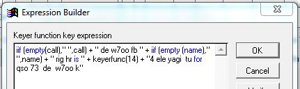

I have a totally unrelated question.... Is there a limit to the number of characters that can be stored for one key in the CW keyer? I have a routine that I have written where I have to split it into two key locations and then call the second location from the first. When I combine the two routines under one key I get the error that there is a problem and then I'm taken to the expression builder. I have checked and checked. The split routines are the same as the one that I have entered under one key storage location. If there is a limit do you remember what it is? I assume that each character entered into storage would count against the total even if it was part of a command. Is that true?

I think there is a limit of 128 characters for an expression -- the expression, not the result of that expression. Post what you are trying to send and I can advise. What does the error message say exactly?

As far as the CW Keyer problem goes I'm sure that the 128 character limit was what was getting me. When I try to load SNIP-A and SNIP-B into one key it takes me to the expression builder. By having one key call the other it works just fine.

For the function keys, it is possible to have one function key call another. I see you are using this feature already. So try putting for example
KEYERFUNC(1) + " " + KEYERFUNC(2)
into function 3.
I think the fact that 2 calls 14 won't be an issue.
