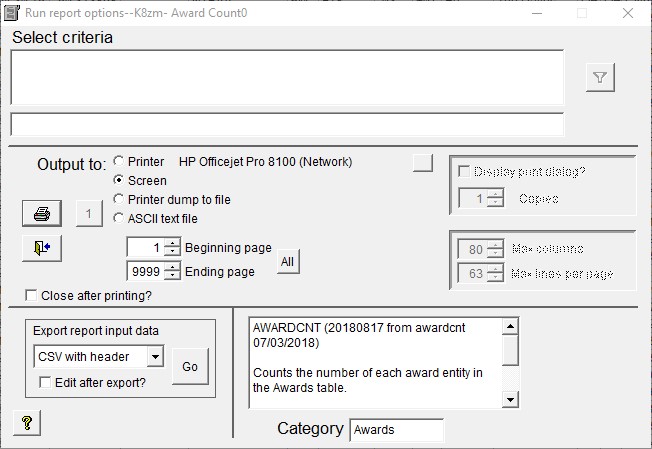

1) Running any report and before printing begins LOGic opens the "Run Report Options" form where you can choose options for printing, i.e., Select Criteria, Output To (Printer, Screen, Printer dump to file, etc.). If I choose "Output To Printer" and click the printer radio button the report prints fine. If I leave the "Run Report Options" form open and again click on the Printer radio button the report will print a second time just fine, I can do this all day long IF the "Run Report Options" form remains open.
However, if I close the "Run Report Options" form and run a new report, clicking on the Printer radio button immediately pops-up a LOGic dialog box looking for a Tables/DBF (*.dbf file) in the root directory of LOGic. Its near impossible to close this dialog box by clicking on "Close", each click gives a windows "DING", I got it to close once after hitting Close over a hundred times. If you try to "X" out of the window it does the same thing and hitting Escape also does the same thing so your forced to do a CNTRL-ALT-DEL to open Task Manager and do an End Task to shut down LOGic.
Tried checking Close after printing in the "Run Report Options" form, that didnt work, also tried to modify the report by enabling CLOSE AFTER PRINTING, no luck with that either. Dennis you may need to log in to my PC to see whats happening.
