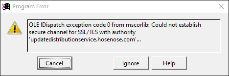

Must be something else, here's what LOGics Updater is returning...
PS: Also did the update to the updater client and get the same error.
From LOGic Updater.png (93kb) downloaded 9 time(s).

PS: Just Reinstalled LOGic just to be sure, same error. If running an update from within LOGic I get "OLE!Dispatch exception code 0 from mscorlib: Could not establish secure channel for SSL/TLS with authority 'updatedistributionservice.hosenose.com'..." (attached) along with the previous error.

Regarding the update error, if you've already verified that it's not due to the firewall or proxy server, try checking if your browser's security settings are updated and allow the use of recent TLS protocols. You could also check that access is exclusively HTTPS. The client and server are having communication problems, and that's where the handshake error occurs. I'm just guessing, but Dennis can certainly give you the right advice. Also consider the possibility of an expired SSL/TLS certificate. I hope he fixes the problem soon. I seem to recall, however, that version .30 was updated twice. Following Dennis's advice in a forum post, I also redownloaded it, but I don't remember the real reason.

So, I think i have exhausted what I can do. I have turned off the Firewall and Virus Protection, checked browser settings (Microsoft Edge) and insured its the latest version, checked TSL/SSL settings, performed Microsoft SFC /scannow with no errors, as well as other stuff like re-install LOGic, perform Clean, clear temp files, perform Microsoft Disk clean-up including system files and reboot of the PC, most of this is un-related but I am a loss so I tried everything but the kitchen sink. The error is the same and seems to indicate the update server site is being blocked.

PS: Running the latest Edge browser v138.0.3351.95 (in fact just updated today). Also went to SSL Labs and ran a test for SSL/TLS Browser Capabilities, Protocols reported as follows:

The attached pic "ProgramError" is what I get when trying to check for updates from within LOGic (Help/Check for updates) followed by the pic "LOGic Updater-UnhandledException". The Program Error says it could not establish a secure channel for SSL/TSL, the UnHandled Exception says site blocked because it may contain unsafe content. I posted these pics before but again here. If I run the updater from LOGics program folder I dont get the "ProgramError" but it does throw the "UnhandledException".
LOGic Updater-UnhandledException.png (93kb) downloaded 2 time(s).
