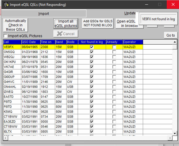

I tried your suggestions of Chrome & Edge for downloading pictures and still no luck. I also tried with my WA2UZI login that only has one location. Still the same issue. I use a super task manager (System Explorer v7.0.0) and was able to confirm you are closing and then re-opening the browser after login; this leads to the 'Not Authorized to view this...." message. I also tried setting the default browser to Internet Explorer. No luck; same issue. I then tried Open browser..., Import directly from..., then 'Import all eQSL pictures' button. For the W2ZI login (2 locations), same error. For the WA2UZI login, I did actually get 2 QSL pictures. The strange part is the message when I hover on the button says it does not try 'not in log' QSOs. I've attached a screencap of that form and it apears to indeed check the 'not in log' QSOs. There were around 40 (of 8400 good QSOs).
I did notice serveal orphan copies of the drivers still running (geckodriver, chromedriver107, and IEDriverServer) after I had closed out LOGic.

The last update to Logic 10 causes Logic to crash when trying to download pictures. When I went back one update, it worked. 73, Jim
