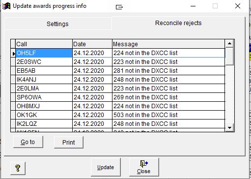

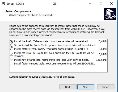

I did install the 9.20.15 update and selected the option "Install new awards list, membership list and the user-defined list" Capture-1
I did then run the Update awards progress info and got error message like "OH5LF 24.12.2020 224 not in the DXCC list" and many more of those. Capture-2
I downloaded the update again and did the install with the same options and still the same.
What has happened?
If I do print a dxcc award list all is ok there.
Any Help please.

#2 Posted : Friday, December 25, 2020 12:00:48 PM(UTC)
Billi
Posts: 36
Location: Akureyri Iceland
Was thanked: 4 time(s) in 4 post(s)
Well all sems to be ok now.
I dleted the qso´s with the error installed the update again did a clean in reimported the qso´s and as far as I can se all is ok. for now anyway.
73 Billi TF5B
