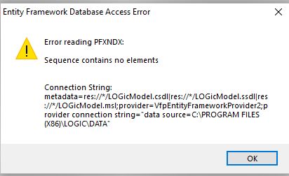

When upgrading from 9.20.10 to 9.20.14 I get multiple errors.
Entity Framework Database Access Error
Error reading PFXNDX:
Sequence contains no elements
Connection String:
Error 1098 "Prefix lookup setup failed" has occurred in
program
PREFIX/LOOKUPSSETUP. line 32
Attempt to continue?
How do I fix this?

Sorry for the problem.
I haven't run into this before, but here are some things to try.
Reboot your computer.
Go into C:\Program Files (x86)\LOGic\data
Delete PFXNDX.DBF and PFXNDX.CDX
Install the latest update. If you do not have a copy already downloaded, go to the LOGic Updater in the Windows start menu or type LOGIC UPDATER in the Windows search box.
Please try selecting the INSTALL FACTORY PREFIX TABLE option while installing.
Did any errors occur during installation?
