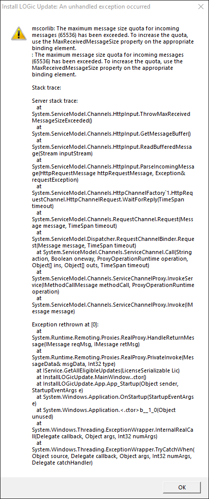

I notice 9.20.14 is available however, when I try to update (either by using LOGic updater or HELP > Check for updates), I get an error message with a lot of text that begins with:
"Install LOGic Update: An unhandled exception occurred"
mscorlib: The maximum message size quota for incoming message (65536) has been exceeded. To increase the quota, use the MaxReceiveMessageSize property on the appropriate binding element".
Any idea what this is?

Same here, attached is the error message. Running v9.20.13 which had otherwise worked great since its install just before the ARRL Nov Sweeps, also worked great during the contest this weekend. I ran updater (LOGic not running) and the error immediately pops up. I'll try to re-install 9.20.13 again and see if that does anything.
Update: Re-installed and still get the error.

Sorry for the problem. You have an old config file. A newer one is needed to handle the number of update records that are sent by the server. It was fixed long ago, but somehow an old file got introduced into the works somehow. Installing 9.20.13 caused the problem.
An update to the updater is attached. Please download it and run it.
Again, I apologize.

All is good !! Thanks for the quick fix !!
