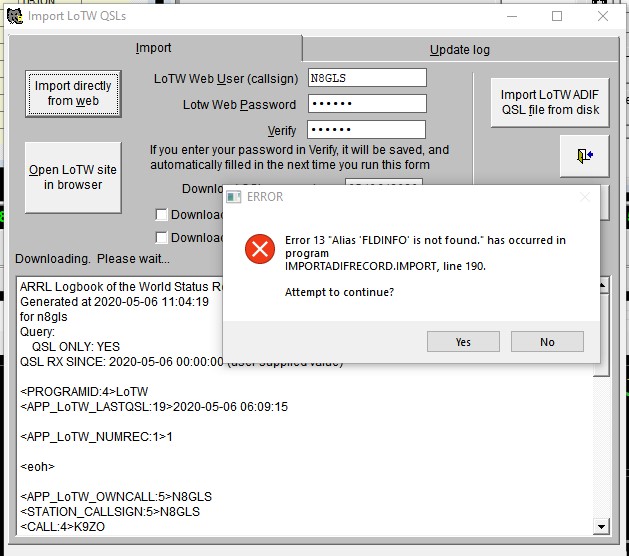

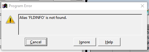

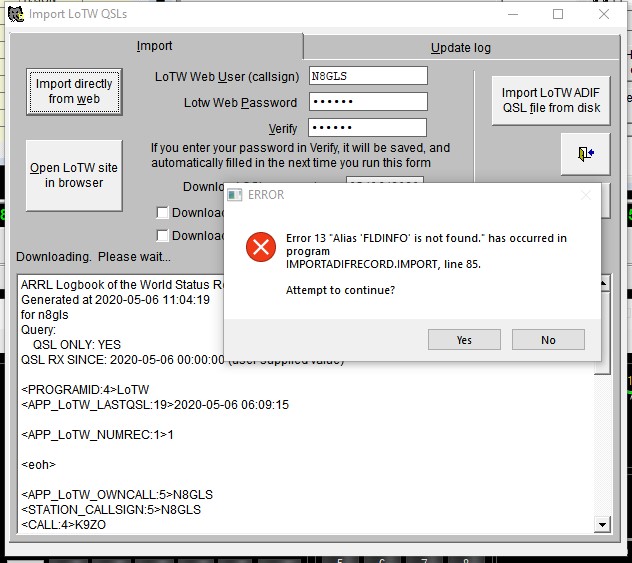

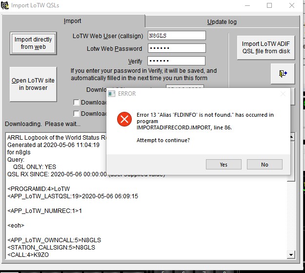

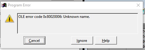

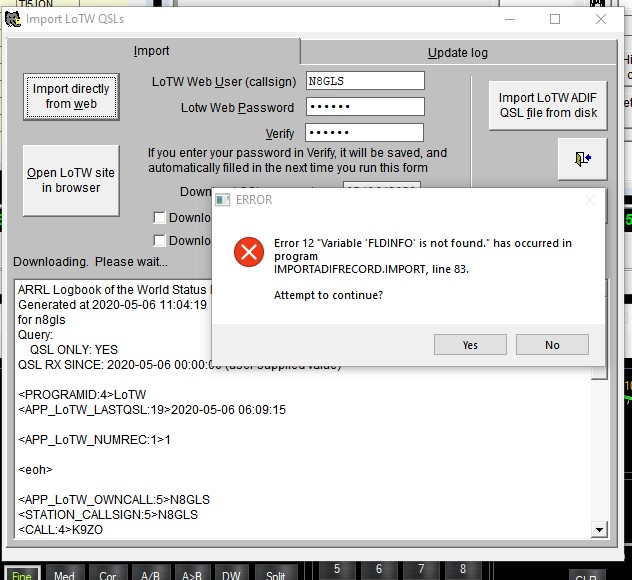

Sorry to report I tried to import QSL's from LoTW and got a mess of errors. Attached are the first 6 in the order they appeared. Clicking ignore it keeps going on, clicking on cancel LOGic closes and performs a clean and is stable until the next LoTW QSL import attempt. I stopped SafetyLog then did a clean then re-launched LOGic and tried another LoTW QSL import and got the same errors. I did not try to upload to LoTW yet so if you need me to try that as well I can.
I have back-up files from yesterday and have yet to clear the recycle bin so if anything is needed from there I should be able to find it.
LOGic is logging so I'm still functional.
73, Brad

Ok, try THIS! Pease download and install 9.20.5 again.
These were easy to reproduce and fix.
Let me know. Sri for the problem.

LoTW upload/download produced no errors, and Logging a QSO via WSJT-X produce no errors, BUT...after logging via WSJT-X and deleting the "fake" QSO I got no errors and all looked good. Then I ran an awards update and it reported 10,409 QSO's in the log......except.....I only had 10,401 as of this morning (I track this stuff daily...anal but it pays off !!) so I gained 8 QSO's somewhere. I did a clean and an index pack and rebuild, the QSO count remained at 8 plus. The last QSO's in the log were correct and I couldn't see any new ones, so maybe just a count error somewhere.....well found there were 8 duplicate QSO's added somehow. I only found them by scrolling through the log and noticed an N in the LoTW sent field, then did a search on that n and found all 8. All were exact duplicates except for the LoTW sent field (thankfully). Even more weird is these were QSO's from 2019.
I'll run some more reports to make sure no other weird stuff going on.
Thanks again !!
73 de Brad, N8GLS
